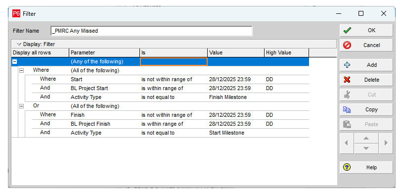

My team members need to be able to filter programme data between two dates.  One is the current programme Data Date - obviously this is available in the filter as "DD".  The second is the previous programme Data Date; P6 doesn't store this anywhere.
The filter that we are using is quite complex, and the date for the previous DD needs to be entered at least four times.  In addition, every month or so, the DD will change, and hence the previous DD will need to be updated in the filter.
I thought it might be possible to use either an Activity or Project User Defined Field.  For the Project UDF, I created the date field and entered a value on the Projects tab.  For the Activity UDF, I created the date field, entered a value, and replicated it through all the activities.
In the filter, it is possible to use the Activity UDF and to compare it to fixed date values.  However, this does not do what I want.
I would like to filter to find activities with the Start date in between Previous DD and Current DD.  It accepts DD in the High Value field.  But it does not allow me to refer to the Previous DD UDF in the Value field.  P6 only allows a date to be entered.
Is there any way that this can be achieved.

I think you are correct in saying that P6 won’t do what I want. So I think my workaround with multiple filters will achieve the solution for 98% of our planners. The remainder will have to manually edit the dates in their own filter. We have significantly different experience levels across the business. Some are new to P6, having come in from MSP and Asta, or are new to planning, so we are trying to keep the solutions as simple as possible. Others, like myself, have much more experience of both planning and software. Although a civil engineer by training, I have 30 years experience of programming VBA and making the Microsoft software do what I need it to do!!

This is the one time that I wish we were using MS Project!!  I could have solved this problem in no time using Visual Basic in MSP!  Oh well...
I think I'm going to have to attack it in a slightly different way.  I will set up a global layout with filter that gets rid of anything that we aren't interested in for this (WBS summary, level of effort etc).
I will then set up a number of global filters for each of the common date ranges.  eg. DD-6w→DD, DD-5w→DD, DD-4w→DD, DD-31d→DD, DD-30d→DD, etc.  Users can then apply the relevant date filter on top of the layout to give the correct data set for their project.  All they need to know is the difference between the data dates and can then select the correct time slice.
If there are unusual dates in a particular period, they can save the filter as a User filter and change the dates there.

David - thanks for your reply.
It's the actual Data Date of the baseline that I'm trying to use in the filter.  And I am trying to compare BL Project Start with the Data Date to find activities that didn't happen in the period.  This will allow users to categorise delays on these activities.
See the image below - a screenshot of the filter.  I would like to replace the date "28/12/2025 23:59" with a user defined field (or similar).  This date is the Data Date of the previous baseline.
The reason for this is the filter will be in a locked Global Layout, and hence the filter cannot be edited by users with standard privileges.  Each programme in our database has different data dates depending on client and operational requirements, so we cannot standardise this.
With a UDF (project or activity), the users could populate the value of the UDF with the previous Data Date.  Then the standard filter could be applied without editing it to show activities in the range DD_Previous to DD_Current.  I realise that I could ask users to make a copy of the layout and then manually edit the date fields in the filter, but this increases the chances of error.
I created an Activity UDF "DD_Prev".  It allows me to add that into a filter in the Parameter column, and to compare that against fixed dates in the Value and High Value columns.
But what I would like to do is to use DD_Prev in the Value column, in the same way that DD has been used in the High Value column in the image.

Take a baseline at each new DD. This should be a universal standard. Then Filter against BL Project Start.....
