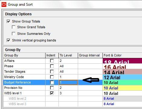

Group & Sort in P6 : How to insert a new field?
Hello
I have a difficulty here. Hope I get an answer.
Can anyone please suggest me how to insert a field in P6 'Group & Sort'. Check the attached snapshot below. I need to insert a field where the arrow mark is pointed.
Appreciate any sort of help.

Hi Frederic,
Currently I follow the same method as you suggested. But there should be other alternate way otherwise Oracle need to consider this in their next version of P6.
If anyone know better solution, kindly inform.

Hi Nith,
I think you have no other choice except to input on line  "Budget Referance" your new value and so on for the lines below.
If anyone gets information on that it would be great.
