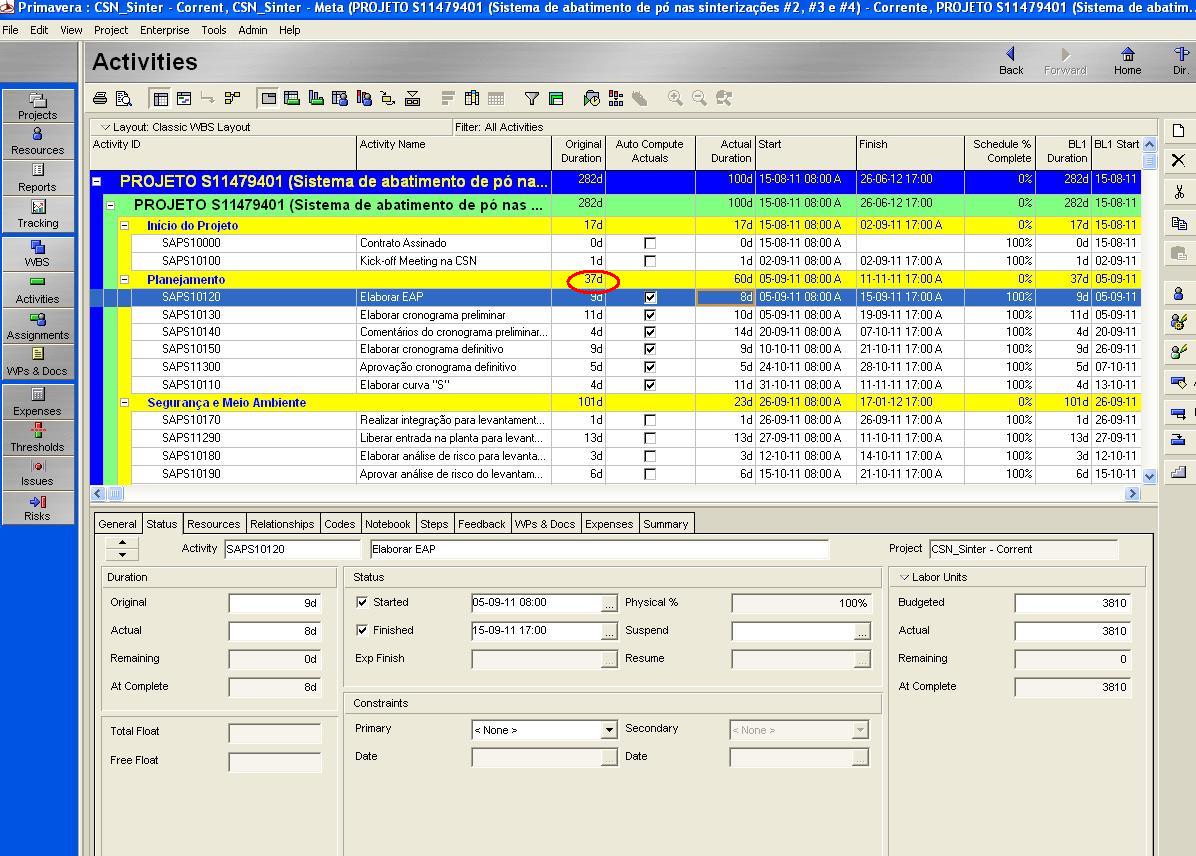

I have to update a Schedule but I am having a problem updating the original duration. In the image above for exemple in the activity "Planejamento" the Original duration is 37d but I need to change it.
Should it be the sum of the sucessors activity? How it is calculated?
Look the image below
M
Marwan Hmood 👤 Member for 14 years 7 months
37 days, calculated from earliest activity start and finish dates. Updating summary OD must be done through updating activity OD.
