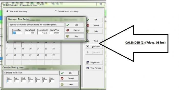

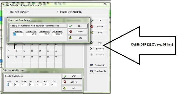

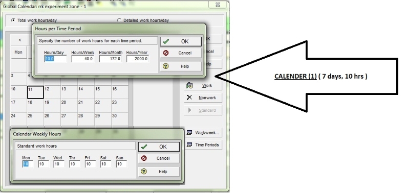

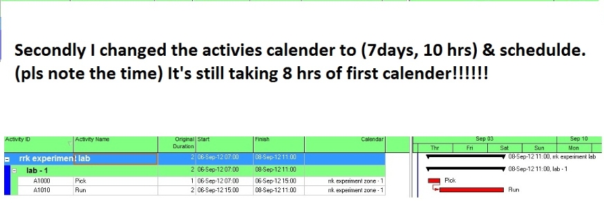

Activity duration will not change by changing the calender!!!!!!!!!!!!!!!!!!!!!!!!!!!!!!! (SCREEN SHOTS GIVEN....pls help)
Arun R 👤 Member for 14 years 1 month
my_doubt_001.jpgmy_doubt_002.jpgmy_doubt_003.jpgmy_doubt_004.jpgmy_doubt_005.jpgmy_doubt_006.jpgmy_doubt_007.jpg

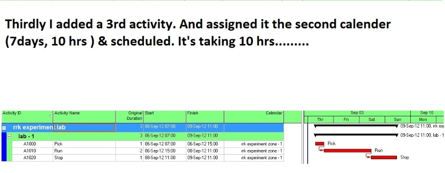

To allow each calendar to specify the activity time period go to
Admin > Admin Preferences > Time Periods and tick the box that says "Use assigned calendar to specify the number of work hours for each time period".
If you then end up having changed the activity durations from 3d > 3.75d, or whatever it may be, due to changing from 10hr days to 8hr days the only way I have found to rectify this is to change these durations using a global change. Specifying the activity calendar and just multiply the duration by a suitable factor, in this case 0.8, to bring the duration back into line.

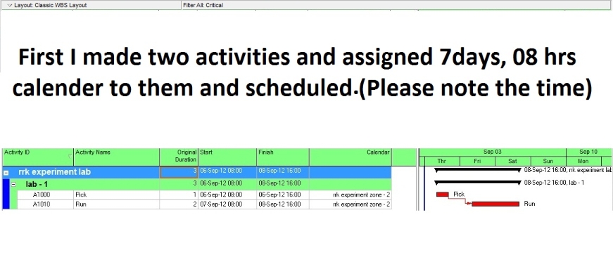

if I understand correctly  you have two activities taking each 8 hours.
If you have an 8-hour workday, both will take the full working day of 8 hours.
Now you change the duration of the workday to ten hours and quite correctly each activity does not take the full ten hours. After all you said that it would take 8 hours to do a particular job.
What you want to do is to increase the duration of each activity in line with the working day; so from previously a full 8-hours to a new duration of 10 hours per actvity. Is my interpretation correct?
Question is why would you increase the duration of activity? If it was a mistrake, fine; and to keep the schedule on track increase the length of the working day. But generall speaking, what is your idea behind this?
I can not remember off hand what P6.7 allows but you could change the type of duration. For instance you could change the duration type to a Fixed Duration & Units/Time. That would allow you change the duration with units/time remaining constant.

                                     First thanks for giving time for helping me. Actualy this is done in P6 V7. I already done what u said. I will explain the procedure i done. First i made a project and before adding activities i assigned it a 7 days 8 hours calender. Then i added activities and scheduled. After adding all the activities and scheduling I changed this 7 days 8 hour calender to 7 days 10 hour calender. and scheduled. But the thing happened is all dates are compressed. All activities are still taking 8 hours only but the time span become 10 hours. For day 1 activity A will take 8 hours ( suppose 7:00 to 15:00 ) and activity B will take day 1's remaining 2 hour and day 2's 6 hour (that is it start from day 1 [15:00 - 17:00] to day 2 [7:00 - 13:00].  And the one thing is if we add any new activity after changing the calender it will take the 10 hour. I think this is because primavera did't change the already assingned working hours to an activity. SO for recalculating this new work hours for all activities is thier any option in primavera p6 v7? please help me.....
