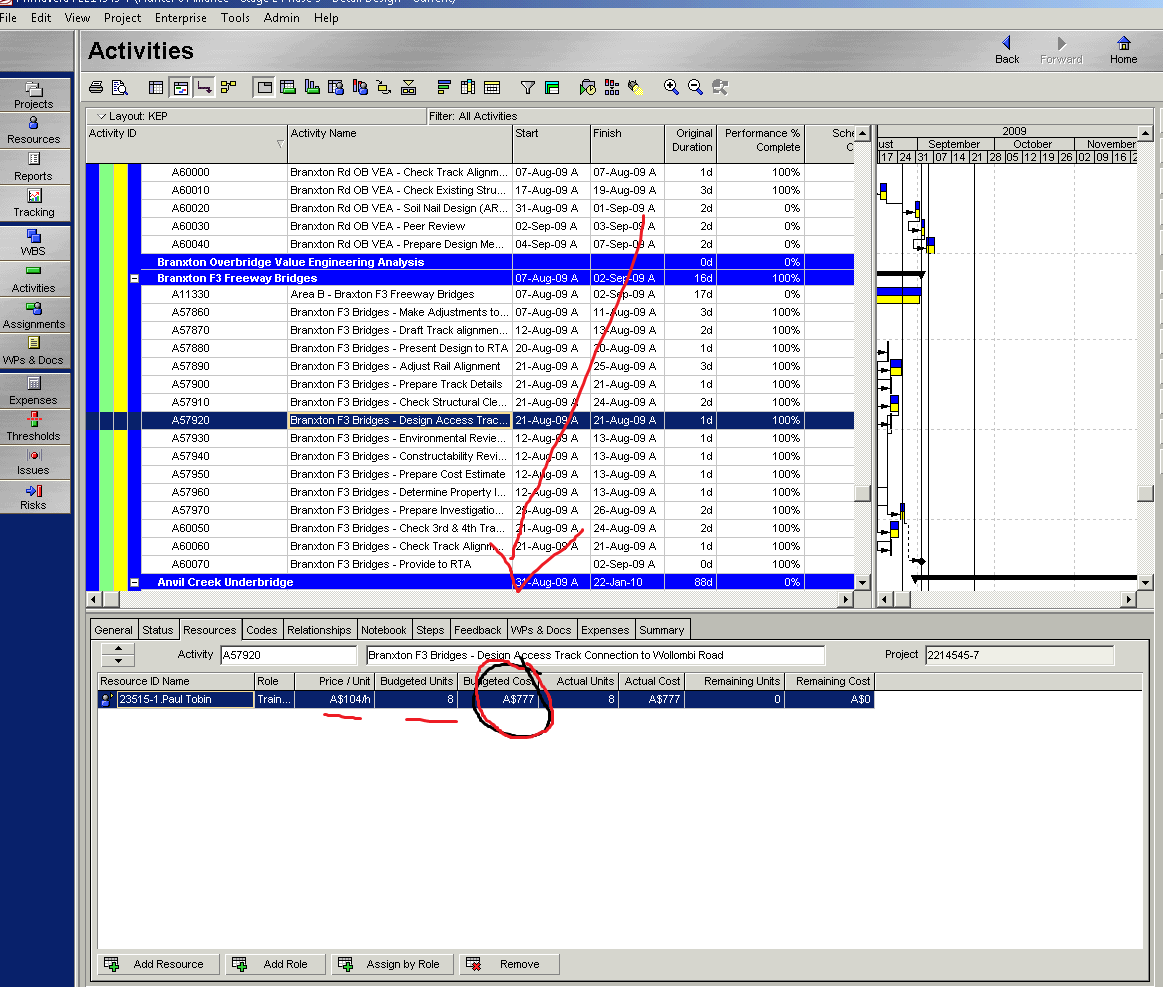

Dear Planners,
Plz refer to the picture, my query is, why the value of budgeted hours (in red circle) is different as we multiply the price/unit with budgeted units (showing 8 but actually its 7.5 hours per day calender), as it should be 104x7.5=780 rather than 777
Please answer.

Kashif,
It could be that your decimel settings need reviewing, as it is appears to be rounding up to the near 30mins, similar to what Mike said.
Although by calculation, it comes out at 7.47115 hours!
Other than that, Paul Tobin owes you 52 bucks (technically)   :o)

Gary Whitehead 👤 Member for 17 years 3 months
I believe this value is calculated using the hrs/day factor in Admin preferences menu, not using the activity calendar

Hi Kashif
Probaly because your work pattern is  less than 7.5 but the number has been rounded up in the display.
Check the hours and minutes in your work pattern.
