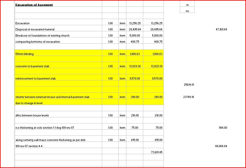

I am trying to create a cost centre for my company here. I have a few question
a) i look at my company bill of quantities and it look scattered and i feel very hard to transfer the cost from my excel sheet prepared by my estimator to the programme. An example of the excel sheet as below. this is only 1 page and this project has 100 pages of excel sheets. sometime, the items in the programme are not the same and sometime, for example, the excavation item done by my estimator include the concrete cost as well. i am afraid i will make a mistake for sure in the end of the thing and i feel very difficult to input the bill of quantity cost to programme. anyone has the same problem? i feel its even impossible to ask my estimator to input all the cost to programme when they do the tendering work? is this an idea or it happen in reality? if yes, how can i do this please?
b) i look at the cost that i think i should divide to manpower, material, plant and subcontractor. should i put more? or just put a total cost which make my life easier? any planner to advise please?

What you have here is a classic problem caused by the estimator breaking down the project into his idea of the components according to his way of classifying and categorising the project components, and your plan wanting it to be broken down another way, ie by tasks. It would have been better if the plan/program/schedule had been done first and the estimator had quantified and costed each task. But since that did not happen, you now have to make your tasks' costs match his estimate.
It won't be easy but at least you know that they must both add up to the same total, and at least the process will force you to review the whole estimate.
