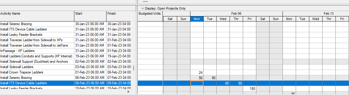

I am trying to distribute hours using resource usage spreadsheet. some of the boxes have turned gray and i can not edit them.
Activities haven't started
actual hours are 0
budgeted hours = remaining hours
Refer to activity "Insert seismic bracing" in below snapshot.
Duartion type is Fixed Units. All activities are fixed units and i was able to edit them. Its just these couple of activities.[[wysiwyg_imageupload::]]

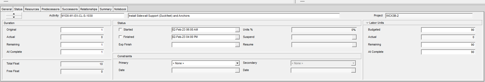

It Worked!!
Great. Thanks for your help.
The issue was duration type. I changed it from "Fixed Units"to "Fixed Duration & Units"
