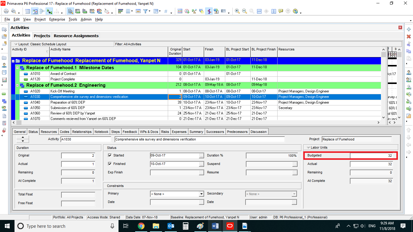

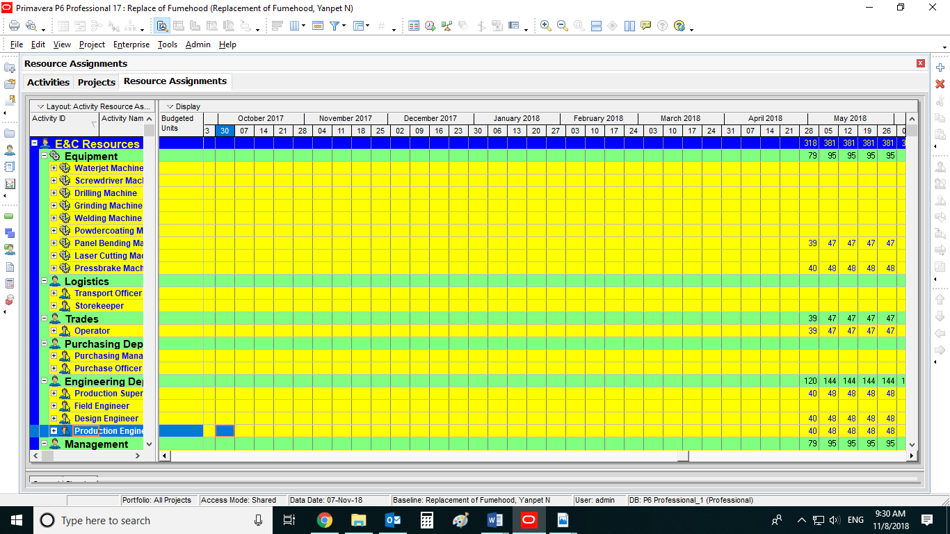

On what basis the Budgeted Units are calculated in the Resource Assignment? I need it to be based on the manhour, but in my Xer file it is based on something else, please chech the attached screenshots shown in the second one that the budgeted units in October was zero only, whereas it is shown in the first shot that I have 32 budgeted unit on the 9th and 10th of Oct

I’m guessing that the bottom image is looking at the remaining units.
The activity you have selected is complete, so the remaining labour units will be zero.
The 32 man hours is budgeted (originally planned) labour units (and 32 hours actual labour units).
Any activity marked as complete will have zero hours remaining labour units.
