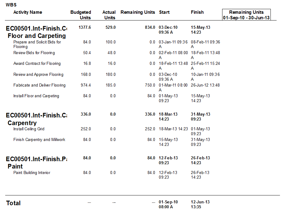

It's my first post here! I made small research and didn't find any answer on my problem.I tried to print out report from P6 but the total row doesn't work. Any idea why the Total doesn't sum up? total.pngOfc I can export data to csv and then make a sum but it's a lot easier to print it directly.

Thanks for answer but It didn't help. In the end I found the true reason, which now is pretty obvious to me..
How to solve the problem?
Just filter by resource type ex. Labor then all works fine! Here's proof:
