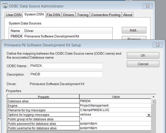

I have looked at previous related topics and they have got me as far as the (hopefully last) hurdle. I get an error when my VB script tries to access the database through PMSDK. My setup is as follows;
  • I am running a standalone install of P6 Professional R8.3.2 with Oracle Database 11g Express Edition running locally;
  • I am using a 64-bit Windows 7 PC;
  • I have successfully installed and configured PMSDK using the 32-bit ODBC administrator;
  • I have successfully configured the database in the Primavera DB configuration utility using the settings:
    • Database alias = PMSDK
    • Driver type = Oracle
    • Connection String = XE
    • Username AND password = pubprm$pm
    • Group ID = 1
  • The above settings result in a successful connection test.
  • Both MS Office and Visual Studio (Express Edition, 2013) are installed in Program Files (x86), but:
    • I am not trying to connect via MS Office application macros
    • The VS compile path does not contain parentheses
  • The code is simply a connection test example; (The project references Microsoft ActiveX Data Obects 6.1 Library. A lot of the other System libraries are located in the .NETFramework folder that is located in Program Files (x86) - could that be the problem?)

  • When compiled and run, the above script fails to connect to the database with the following error messages:
"An unhandled exception of type 'System.Runtime.InteropServices.COMException' occurred in P6ConnectTest.exe
Additional information: [ATI][OpenRDA ODBC]RDA error: Resource not available - Connect error: =PMSDK;Driver=PMSDK;engine=PM;lf=C:\temp\PMSDK.LOG;lo=verbose;pg=1;pp=pubprm$pm;pu=pubprm$pm;.
Error returned from engine: Logon failed: invalid user pubprm$pm
    VDB.Connect; hResult=0x80040011 (PMSDK_E_BAD_LOGON: username/password or license invalid); EOleSysError=SDK failed to logon to driver
Error number: 0x80040011"
  • PMSDK.log gives more of the same:
"150824:22:47:01.862 - VDB.Connect: "pubprm$pm" using params=DB = PMSDK, Public Group Id=1, Log File Name=, LogOptions=verbose
150824:22:47:04.518 - Logon failed: invalid user pubprm$pm
150824:22:47:04.518 - ERROR => Logon failed: invalid user pubprm$pm
150824:22:47:04.518 - VDB.Disconnect"
