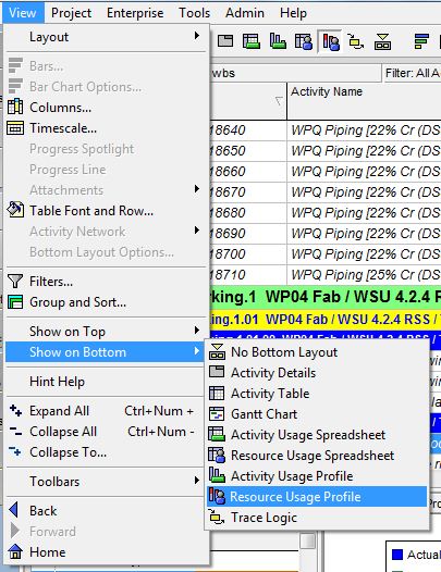

Now when i display resource usage profile on bottom,
It will show every resource that i used, and how may manhours are assigned to that resources.

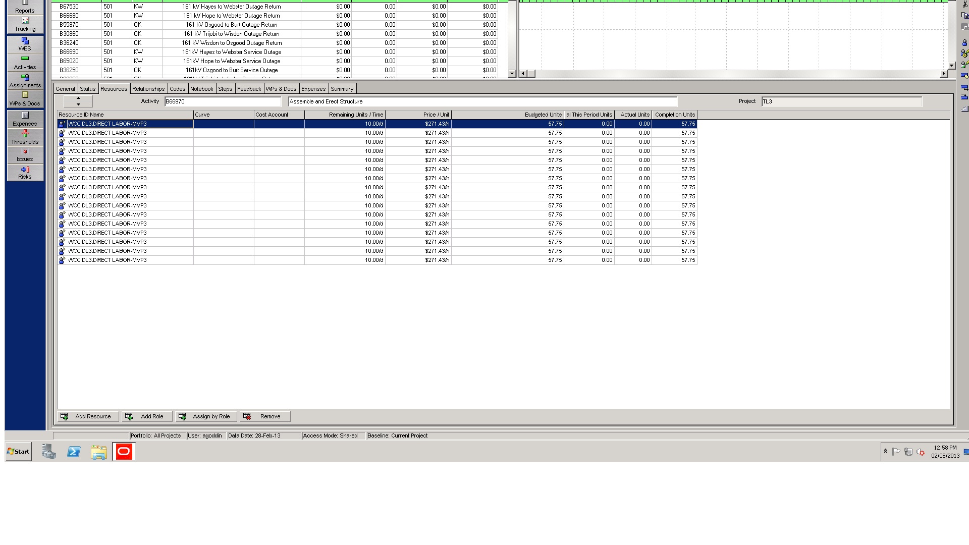

My problem is, the limit is not correctly assigend.
How do i increase a resources limit?
Ravi Katare 👤 Member for 11 years 10 months
Soln:
Go to Resource directory, select concern resource, select units & prices tab & change the Max units/time value.
