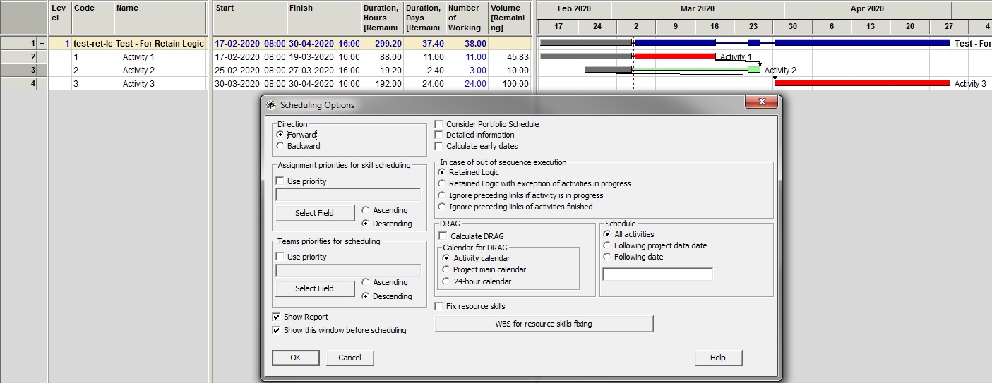

In scheduling options we have 4 options to choose in case of out of sequence execution.
First I want to mention that we currently don't have out of sequence execution above, so none of the above options would be our case.
For first link none of the activities have finished so the logic is correct and when Activity 1 will finish, activity 2 to finish 6 days later.
For the second link, Activity 2 has started and Activity 3 not yet and will start after Activity 2, the soonest possible.
I would expect Activity 2 to finish 6 days after Activity 1 finishes and Activity 3 to start just after my Data Date, that is, 05-March-2020.
I can't get the expected result with any of the above options selected:
  • Option 1 - Retained Logic: It pushes Activity 3 to start after Activity 2 finishes. Like there was link:
Activity 2 --FS0--> Activity 3

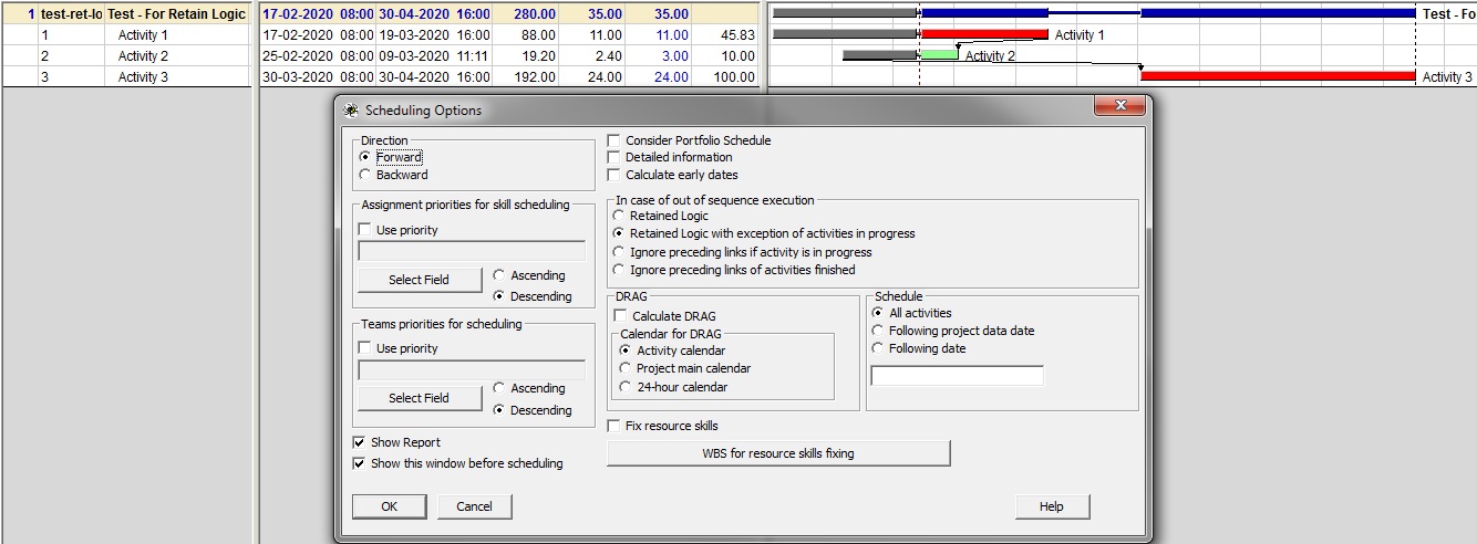

  • Option 2 - Retained Logic With Exception Of Activities In Progress: It shifts Activity 2 to finish As early as possible breaking logic between Activity 1 & 2 of FF (6 Days), and keeps Activity 3 as before with no logic at all
spider_test_for_logic_-_02_-_retained_logic_with_exception_of_activities_in_progress.jpg

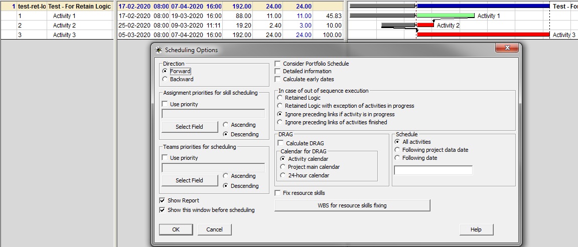

  • Option 3 - Ignore Preceding links if Activity is in progress: Activities 1 & 2 as Option 2 and Activity 3 to start 05-March-2020 as expected (but Activity 2 not as expected)

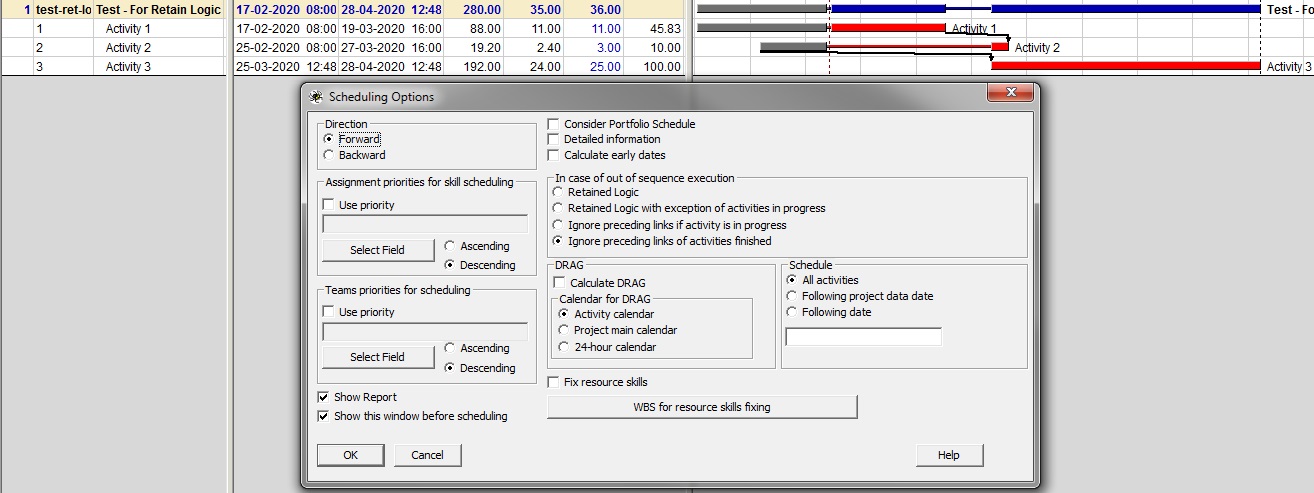

  • Option 4: Ignore Preceding links of activities finished: Activities 1 & 2 as expected, Activity 3 to start when the remaining of Activity 2 starts and not 05-March-2020

Dear Vladimir,
Yes, option 3 works as it should, but only if we had out of sequence execution as the title mentions in the options.
The programme should mention just how we want to schedule globally and not "in case of out of sequence execution".
In the above example we don't have out of sequence execution.
I would like you to send me the version that this error was fixed, if it is possible.
Kind Regards,
Alexandros

But I don't understand what is wrong in the Case 3. In this case preceding links to an activity in progress (FF to activity 2) were ignored.
