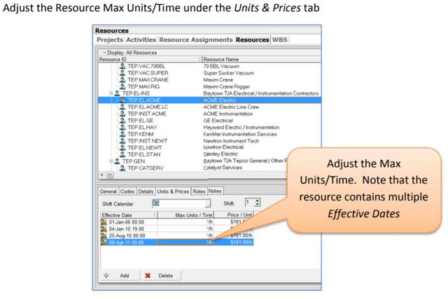

It is possible that David Kelly workaround might work if after pass 1 you increase maximum/units per time for Type 2 activities with effective date after all Type 1 activities finish, use a milestone or a filter to get the date and then run second resource leveling. Upon every update before all Type 1 activities finish the date all Type 1 activities finish might move and therefore the availability profile might need re-adjustment.
The following figure I got from the web might help to figure out how P6 adjust the availability profile.

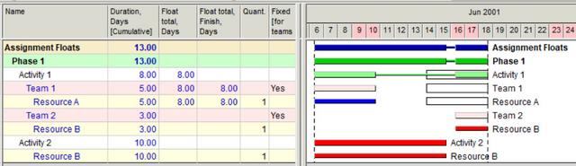

Assignment float can be defined as the amount of time that resource assignment may be delayed without delaying the project finish date. In case of resource assignments when resource teams can execute the same activity independently of each other, resource assignments may be critical even on non-critical activities. An example of such project is shown in the Exhibit 6.

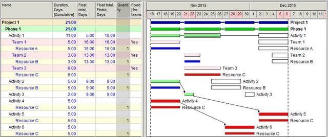

This project consists of only two activities, there are no hard links among the activities. Activity 1 should be performed by resources A and B independently of each other. Resource A is assigned for 5 days, resource B – for 3 days. Duration of Activity 2 is 10 days and it needs resource B to be performed. The project duration is 13 days, so the start of activity 1 can be postponed for 8 days but its finish cannot be delayed without delaying project finish date. In this schedule activity 2 is critical though it finishes earlier than activity 1.
Shift work on same activity is a common case where resource teams can execute the same activity independently of each other.
When you have 3 teams an activity not start and not finish critical might have a critical resource assignment. Such is the case of Activity 1 in the following scenario.

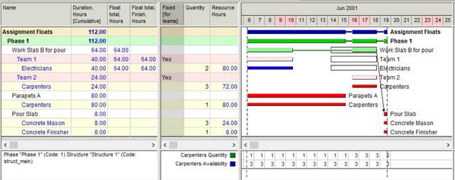

Multiple team assignments for a single activity, each team a fixed amount of work is not rare in construction work.
It is better practice to keep the teams on a single activity, this avoids unnecessary activity clutter that can add hundreds/thousands items to your schedule, this avoids unnecessary activity links clutter that can add more than two links per additional activity, this shows work is not finished until all teams finish their assignment, it avoids the resource leveling spreading apart the sub activities in uncontrolled way.
Usually different teams have different production rates, when you do not have fixed work distribution, the most common scenario, you might not know in advance how work is to be distributed among the different teams working on different shifts on same activity. In such case splitting of activity will not make it.

15 years 11 monthsJust select the Specific
Just select the Specific Resources to be levelled.
Assign a Resources differ from Every Task, then when performing Resource Levvelling, select Specific Resources you requires to be levelled.

21 yearsSean,As you have discovered,
Sean,
As you have discovered, P6’s levelling does exactly what it is supposed to do. Unfortunately, the bar is set somewhat lower than P3 in 1988.
Rafael demonstrating that Spider is at least one generation ahead of P6 doesn’t help a lot.
You can’t level only part of the schedule (P3 could) or trigger it stopping the level.
All I could recommend is after the first pass at levelling, increase the availability of the dummy resource to allow parallel widening activities. and run a second pass.
21 years 8 monthsEasy if using resource
Easy if using resource leveling and activity resource production to increase resource availability by activity resource production instead of using fixed dates to define availability.
You can set any resource availability by fixed calendar or by activity resource production; the initial availability can be 0 and then increased/decreased by calendar dates or resource production.
so easy!
