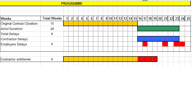

Thanks for your response, i read the contents of this case.
The parties agree on certain bespoke amendments to JCT Design clause 2.25.13(b) and hence award of extension of time was dealt accordingly.
But FIDIC conditions of contract does not have such requirements under the contract. The risk of concurrent delay is not allocated in the contract document , is it fair to consider the dominat cause approach and not to award time to contractor for the delay appear concurrent to employer.

8 yearsDear sir Thanks for your
Dear sir
TThanks
Bilal
19 years 10 monthsHi BiallaIf you are in the UK
Hi Bialla
If you are in the UK then the current ruling is that the contractor gets EoT for week 24 plus costs.
He pays LAD's for wekk 16 to 23 and no costs.
This is because of the new ruling on North Midland v Cyden which brought us back to the dominant delay principle.
Other more sensible countries will apply an apprtionment of the different delays - more or less as you have shown in your bottom line.
