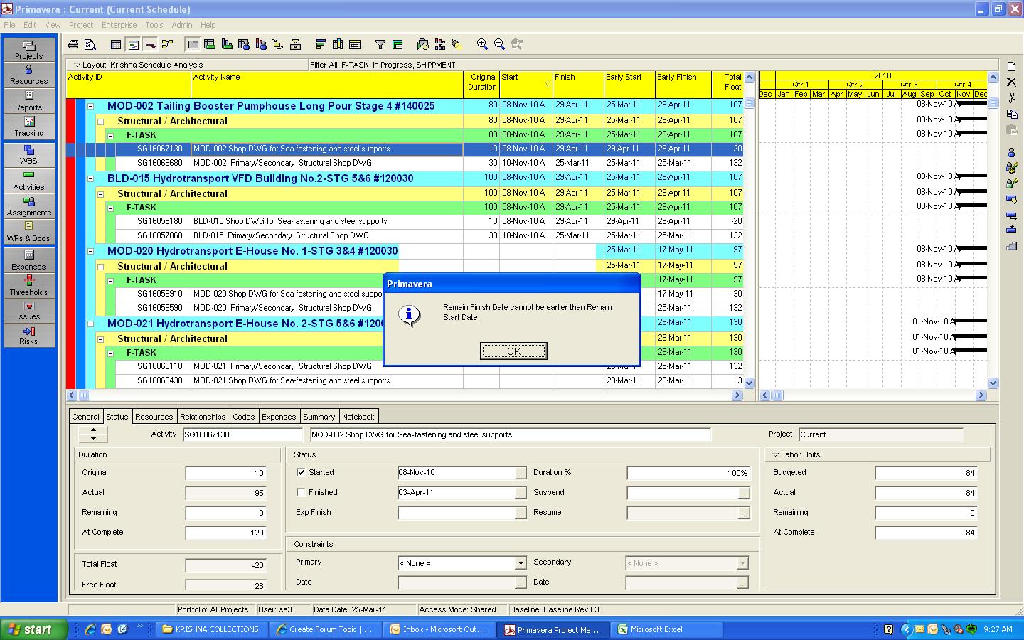

Facing problem while updating actuals.
Krishna Kumar
User offline. Last seen 13 years 16 weeks ago. Offline
Joined: 8 Feb 2007
Posts: 25
Hi Planners,
                 I have got a problem with updating actual dates, while i updating the actuals its showing like the attached image. Kindly give me a solution to clear this.
Krishna

Hi Kumar
Is it general, finish date cannot be earlier than start date.Check the dates of the activity which has created this issue.
