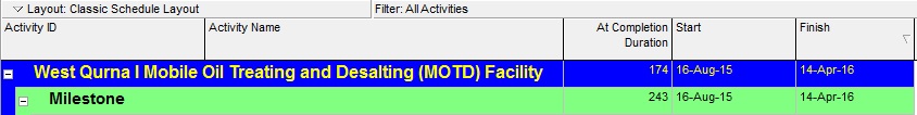

Hello Everyone,
The is a Difference in Duration in the WBS. The Project Duration is shown as 174 Days and Milestone Duration is 243 Days (which is the calendar days).
5324
I have 3 Types of Calendar in the Project a). 5 Days Work Week, b). 6 Day Work Week and c). 7 Day Work Week.
The Default Calendar of the Project is 7 Days Work Week.
Could you please guide me on how to show in the Project Duration as 243 Days (Calendar Days).

just make sure that you set a defaul calendar for the PROJECT

Got the Answer after doing some research,
I went to Enterprise - Calendars - Global Section - Then I moved Default Calandar Tick from the Calendar which had a 5 Day Work week to 7 Day Work Week.
Now the Total Duration is same as the the Below WBS Duration.
