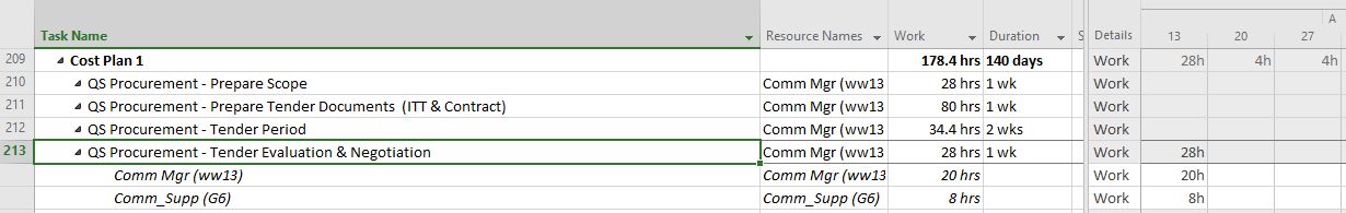

Just wondering if there is a simple way to expand each task on the Task Usage View so that it shows individual resources against the task rather than the total for all resources?
In the example below, I have manually expanded task 213 to show the two resources and their hours, but I can't seem to find a way to do this quickly. I've tried using "Outline-Show All Subtasks" but I suspect that this only works with tasks and not resources.
Other than manually opening each task or exporting the information to Excel, is there a quicker way to do this?

It looks as if the problem I am having is a result of filtering out the tasks. It is a five-phase project, and I am populating just one phase.
All of the tasks have a Phase reference in a customised text field, but I noticed when expanding each task that the resource allocations do not, so simply by pasting the phase reference against all of the resources on the task usage view, the problem is solved.

Thanks for replying. I can use the "Outline-Show All Subtasks" or "Level X" options to show all the tasks without any problem.
However, if I want to show each of the resources allocated to the tasks below the task name (as per line 213 in the extract above), the only way I can do this is by clicking on the expand arrow against each task (rather like opening out a summary bar).
Unfortunately this is extremely time consuming, and most of the time I am trying to do this, I manage to click outside of the expand arrow and all the resource rows are then hidden again.
Should have mentioned that I am using Project Professional 2016.
Since posting, I have been doing a bit more searching and on previous versions of MS Project, you could apparerently achieve this by using Resource Allocation via an option on the "outline" icon, but which seems to have been removed in MSP 2013/6.
