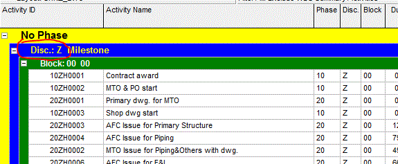

I am organizing my schedule (group & sort) by activity codes.  For some reason, the activity "code value" and description is being displayed.  I don't want the code value to be visible.  Can someone help?

Gary, thanks for that.  I am wondering if/how this is any different from going to the "Group & Sort" icon and unticking the  Show: ID/Code box in the bottom right.
We tried everything we could think of last week, but nothing was working.  Thanks for your help!

Go to View > Group & Sort, and untick the Show: ID/Code box in the bottom right.
