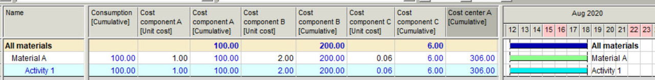

Rafael Davila 👤 Member for 22 years 3 months
With Spider Project we can apply as many cost codes we want either at fixed cost or at unit cost.  I expect you should be able to create similar models.  Within P6 having the option to apply different rates to the same cost code helps.
UP-cost-components
Materials-cost-components
