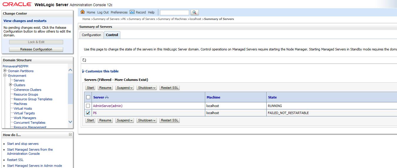

Hi, I'm a newbi in Primavera and WebLogic. I have installed Weblogic 12c(12.2.1) and Primavera 15.2 on Ubuntu 14.03.4 server.
Now I cannot start P6 server but AdminServer is ok.

I understand that something is wrong with Java. But what?
Igor Knex
User offline. Last seen 9 years 16 weeks ago. Offline
Joined: 20 Dec 2015
The java exseption was caused by the next arguments : -XX:+UnlockCommercialFeatures -XX:+ResourceManagement. Now my problem was solved.
