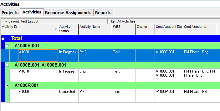

we're looking to make use of Cost Accounts within our projects, and I have a small question to ask of the experts.
If we have two resource IDs on an activity, both with the same cost account allocated - is there a way for the activity to be grouped with other activities with the same?
Currently I get as far as the below screenshot, and it keeps them separate.
Any ideas much appreciated

Hi
in the Activities windos, for the layout use the Group & Sort icon, starting with Accounts ID.

Cost account is an attribute of the Resource Assignment and Expenses tables. Therefore, you should be in the Resource assignment rather than Activities window to group by Cost account. Of course, you then cannot list activities without a resource.
