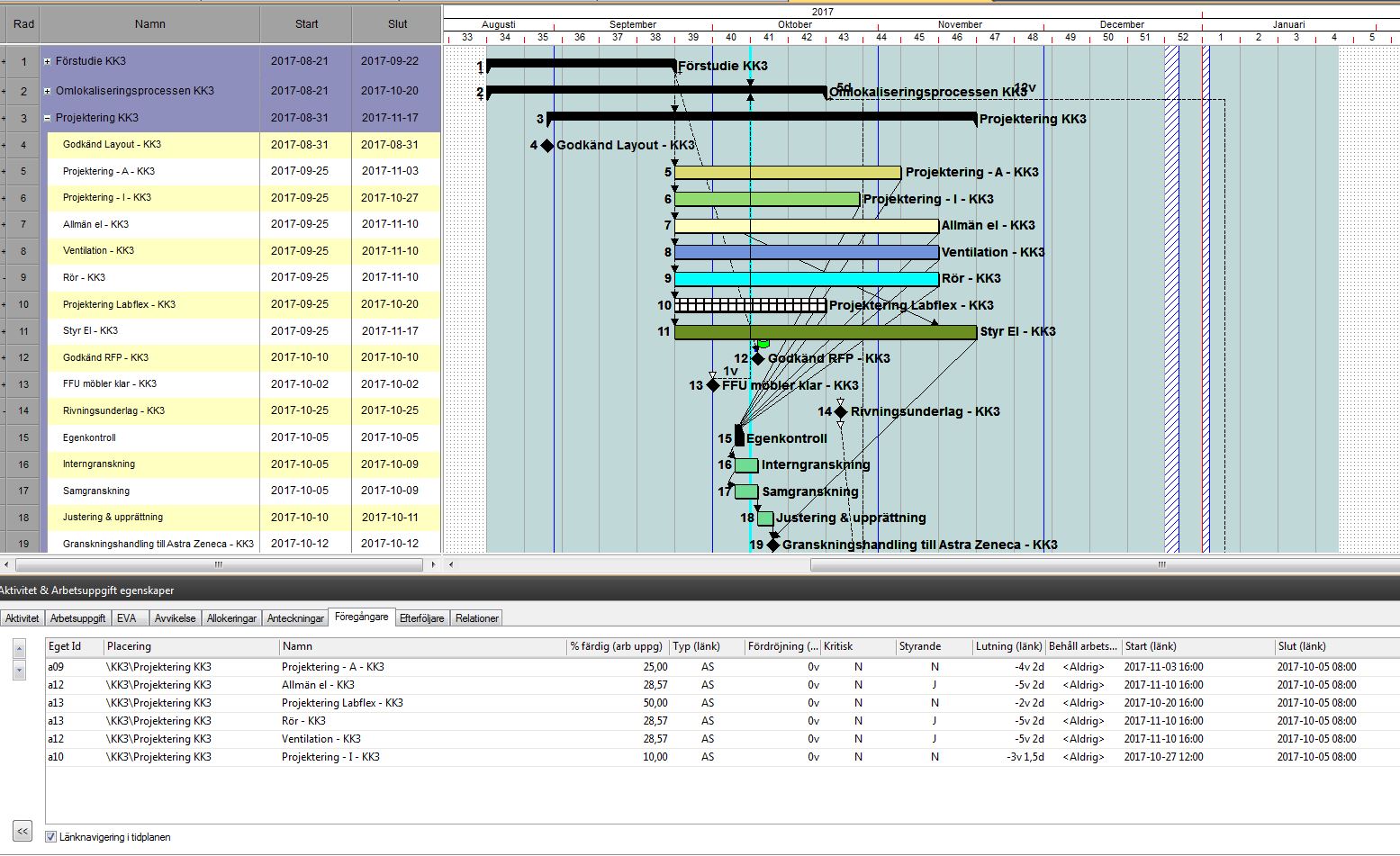

I was born and raised with Primavera but recenlty started using Asta as well to broden my knowledgebase. The addaptaion has not been smoth and i struggle with the idea that Asta is somehow superior to P6. But maybe it's just my way of thinking that is at fault?
Here is an example i struggled with all day today.
Activity 15 is not started. 0% complete. Has both succesors and predeccesors. Yet somehow when i scheduled the project not only did it jump backwards so that it starts before it's predecessors are completed but it also starts (and ends) before the status update line / Datadate?
How on earth can this be so?
And in addition activity 4 has been marked as finished and i've set the actual date to be 2017-09-22.. yet when i schedule it jumps to actual start 2017-08-31! Eventhough its predecessors are completed at 2017-09-22.
To me this goes against all logic and reason. So either the program is faulty or there is something that i haven't taken into account. Which is it?

Hi Andrea There may be a conflict with your calendars - particularly if you have resource modelling in place using their own calendar. Check if your summary bars have any logic attached. This distorts the task logic and should be removed. It is possible that you have a logic flaw in that particular file. Open a new blank project and copy - paste the old programme entirely into the new. Finally Asta Project Support is always available by phone or email. Best regards Mike Testro

Check activity constraints there may be a "Finish on" hard constraint.

Your suggestion didn't result in any change but when i changed the "status line" in the options below that tick box the activity jumped forward to its more logical position. I find this very curious as the logic should have placed it after its predessecors no matter what date the status line has.

There is an option in reschedule that allows "Link around completed tasks" try that.
