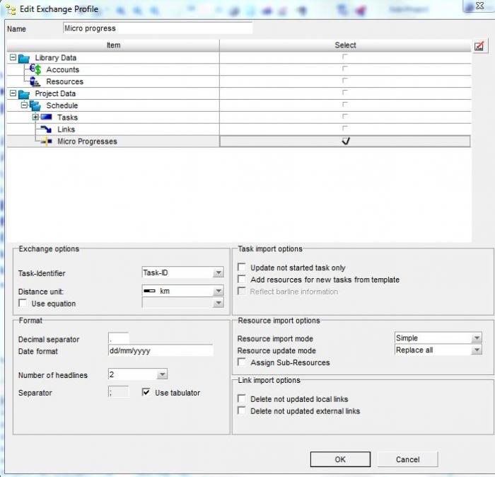

Am doing import of micro progress, everything working fine except month date on progress is being changed from December to January.
Anyone experienced this? Have checked parameters and everything looks OK here, see below;
Advice appreciated.

This was due to date format being different, I had originally matched excel format, however when excel copies to clipboard it changes the format from dd/mm/yyyy to dd-mm-yy once I altered this all good.
