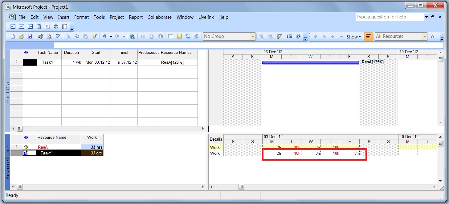

In MS Project, there is a possibility to do a Manually Editing of Timephased Assignments. That means, that I can assign resource to a task and then go to task usage or resource usage and manually edit the amount of work the resource is scheduled to work. I can make intervals of assignments as small as 15 min.
See picture below:
1414
May be I didn’t search well, but I couldn’t find this feature is Spider. I only found how to assign resource to task with permanent loading.
 Did I miss something?

I agree, that time phased entries are is not the most important feature, but I personally use it for the following:
Just wondering what functionality is available in Spider to achieve the same goal?
At the planning stage
Sometime for planning of a budget I assign resource to a long going task (e.g. I assign Project Manager to the task Manage The Project. This task goes from the beginning till the end of the project). I know from experience, that Project Manager would not be loaded equally through the whole period, but he will be loaded at lot at the beginning and at the end. So I would do manual adjustment assignment to reflect on this. Actually MS Project has built in possibility to do this adjustment for you (back loaded, front loaded, Double Peak, Early Peak, Late Peak, Bell, Turtle ) . E.g. see example of front loaded assignment.
From
At the tracking stage
When you track actual hours spent, it is also useful sometimes just for recording purposes to record actual hours spend with the precision down to a day or even less. (e.g. Mon - 8 h of work, Tue 10 h of work).
So far in Spider I  did not find possibility (and maybe I didn’t search well)  to enter actually spent hours for every single day of the last week (assuming you update schedule weekly, but still want to have actual hours recorded on with the precision of a day)

On assignments at a single Job I would use variable workload functionality available in Spider Project, in this way resources will be assigned to work in a way that idle time will be minimized.
Spider does not permit this and I don't think that this function is useful. If resource workload is changing for no reason then the work changed and it is necessary to create new activity. But Spider models variable resource assignments when resource workload may change because it is used on parallel activities and requirements there are changing (for example some activity was finished and resource availability increased), Spider is a tool for project modelling, drawing schedules and playing with resources manually is not what we call scheduling.
