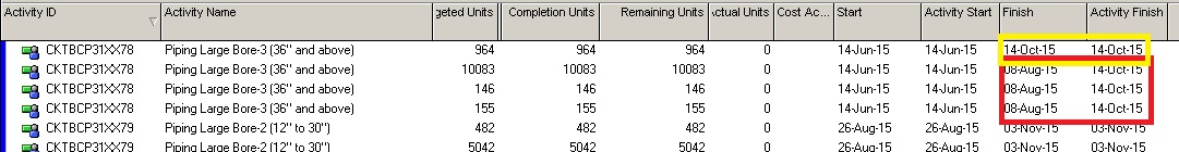

I am experiencing consistent problems with the dates on the Resources assigned to an Activity being at variance to the dates of that activity despite them being originally aligned.
Does anyone know the mechanism, settings or steps that may been taken that will cause these dates to become misligned, the images below from the Assigments View illustrates the problem.
2208

Zoltan, All reources and activities are using the same calendars. I do not believe this has anything to do with calendars, because if it was so, the assignment dates will mismatch from the acitivty early dates to begin with, and not just after changing activity dates and re-scheduling.
In this case, the assignment dates match the Start and Finish dates of activities, but after making changes to activity dates and Re-scheduling, the assignment dates loose the link with the activity finish dates. This only seems to happen with certain activities, even though they have the same properties as the other activities.
 Perhaps, the assignment dates seem to latch onto the planned dates for some reason, and not the Early dates? I wonder if there is a setting somewhere in Primavera, which ensures the assignment dates move along with the activity early dates.
I have seen this issue being raised by quite a few patrons here with no solution yet.
  I do not believe it has anything to do with Calendars, because if it did, the assignment dates will be different from activity dates to begin with, and not just after re-scheduling.

Does anyone know why the link between Activity Finish dates and Assignment finish dates breaks at some point?

View Projects --> Tab "Resources" --> Mark "Drive activity dates by default". This will work for new activities.
To correct existing activities: View Resource Assignments --> add the column "Drive Activity Dates" --> mark the upmost then fill down.
Hope this helps
