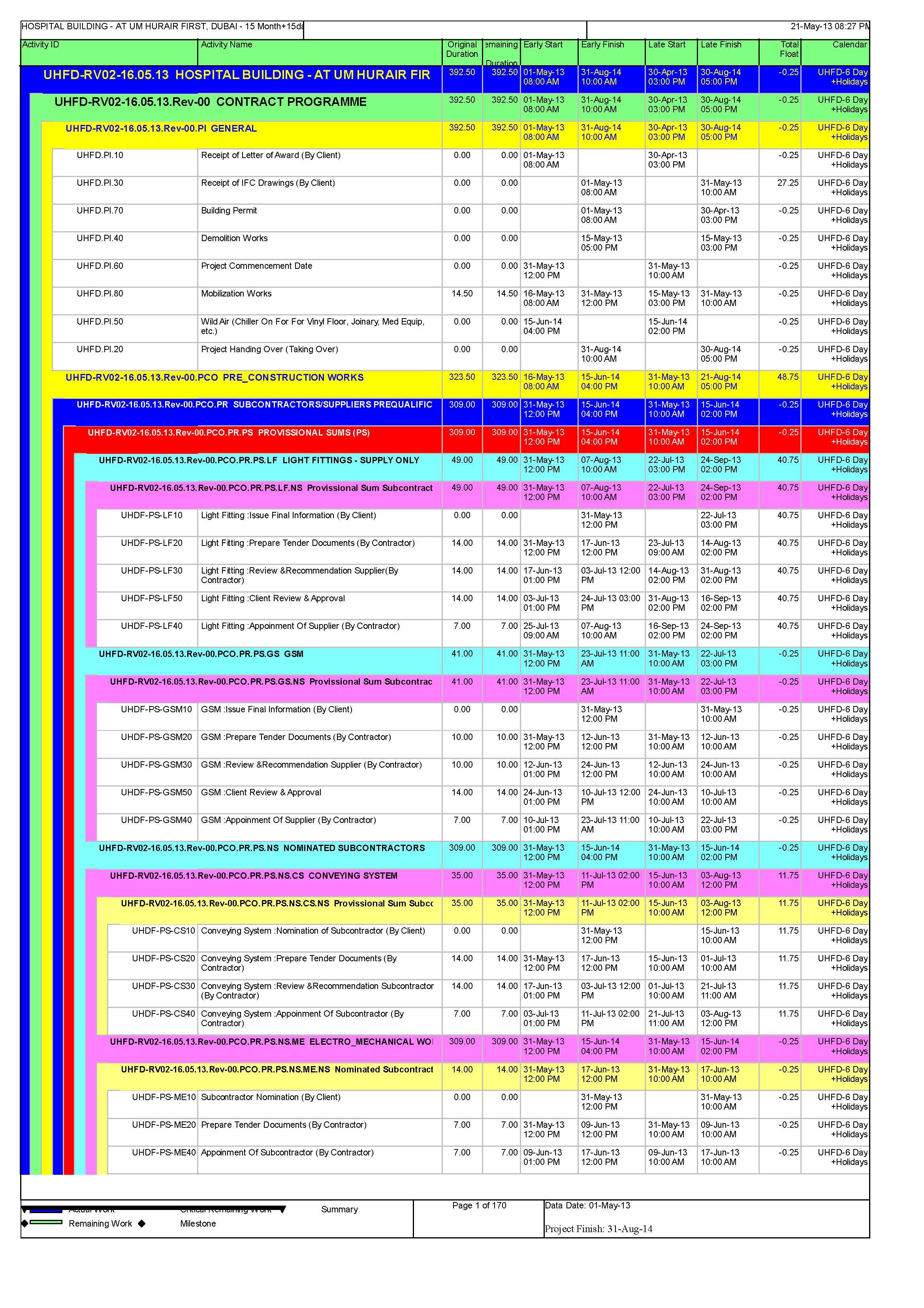

Early Finish and Late Finish not matching and total float has negative decimal float

Are there any reasons other than the above for having a project late finish date earlier than the project early finish date, ,having fractions in total float?
Is it required to impose a must finish by constraint before starting the update process?
John,
There is issue on Time because duration are in fraction. Check the Dates Time.
Must Finish constraint shall be assigned as the Project Contract Completion Date during preparation of Baseline.

As I Know, A Finish Milestone has only a Finish Date and cannot start; assigning a predecessor FS means the finish milestone is supposed to start after the predecessor is finished. A FF or SF relationship is always logical for a Finish milestone.
I removed the fraction in the duration of the actvity mobilization and made it 14 d instead of 14.5 d, this removed the fraction in float.
When i removed the must finish by constraint, the negative float also disappeared; probably because the project must finish by constraint should have been set on 01-Sep-2013, one day after the planned finish date. This is a change noticed from P3 to P6. P3 used to accept the same dates for project finish and must finish by constraint.

Firstly I'm pretty sure you CAN have FS logic with a finish milestone.
You do ideally have a finish constraint on the last activity or the project so that this will drive the float to a required completion date.
The "late finish date earlier than the project early finish date" is being driven by the logic I would assume, you need to review the longest path. Fractions in the total float is only due to the format of the time units!
My worry would be that they have issued a plan that has negative float?? Which is saying that they don't think they can finish on time albeit only a few hours late!! I'd like to see some float in my programmes!!
