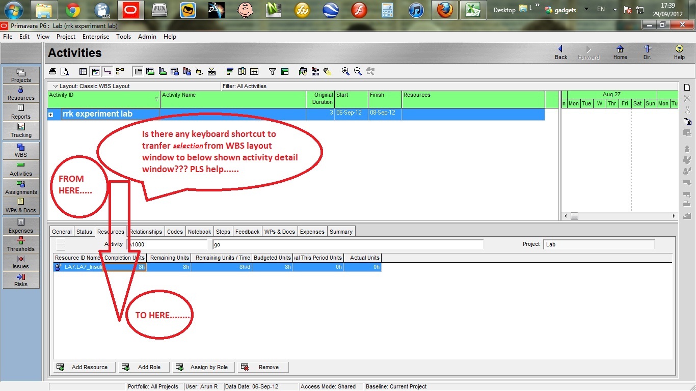

I have a challenge..........Keyboard shortcut for switching between windows in P6??? Can any one slove this???? SCREENSHOT GIVEN

                             Can any one help me in this matter...... Actually I am entering resourses to every activities.....Each time I have to click on each activity then click on the bottom activity detail window in "resourse tab" for assinging or giving material quantity or labour detail................ I hate this....I love working with key board only....... I am in P6.....Any one know any keyboard shortcut for switching between these two windows????????
        PLS HELP>>>>>>>>>>>>>>>>>>>>>>> SCREEN SHOT GIVEN BELOW>>>>>>>>>

I think your question is valid and will be very handy to have shortcuts like that working with Primavera. But as far as I know, Primavera has allowed only limited keyboard shortcuts like Ctrl + C, Ctrl + V, Ctrl + X and Ctrl A. I don't know any other then that. But just to easan your job, I would say if you can go to resource assignments and then sort your items by Resources & activity ids or whatever suits your best, you can easily enter the values for all of them. This is the best I can think of it to halp you at the moment. I think this will be lot quicker to add lots of resources to the program.

Why not just hold down the Ctrl key and hit every letter in turn to see if you get a result?
I doubt if you will find one - P6 is renowned for making life difficult.
