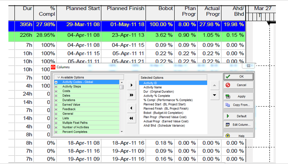

I have problem about layout in primavera, how to setting layout plan value cost, earned value cost  to be percentage in P6.
I have example layout like this. Thank you.

Hi Ranto,
Planned Value Cost and Earned Value Cost can be found inside the Earned Value. During update,to get the planned value you need to set the baseline.
