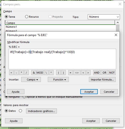

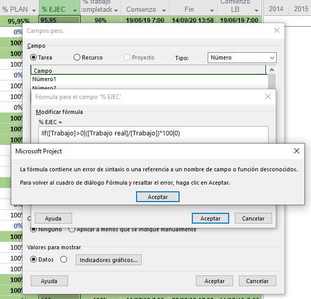

Formula editor shows error with correct formula Greetings. I am writing for the following reason, my copy of MS Project fails when trying to add a formula in a numeric custom field specifically the "Number 2". I tried several times without achieving anything, even modifying the original formula. These are the formulas IIf ([Job] <> 0 | Format ([Actual Job] / [Job] | "0.00%") | "0.00%")IIf ([Work]> 0 | ([Actual Work] / [Work]) * 100 | 0) These are the names of the fields in Spanish, what they do is calculate the executed work with decimals, since project only shows integers. The error MS Project indicates is always in the first PIPE from left to right. I opened a previous file that had one of these formulas included and it works, but when opening the formula and clicking OK, the same error appears ... although the formula works in the file until the editor is opened. Captures of the error are attached ... I appreciate someone tell me that it may be happening, or if it is an additional configuration of the S.O.
7494
7495

Hi Rafael, I did it but still the error keeps appearing. As I indicated, I have other schedules with fields that I have formulated myself but when opening them in this version that they installed me (MS Project Professional 2016 in Windows 10 Home Single Language), now that the laptop is formatted it generates that error and does not let me create or edit formulas. In these schedules they work well if I don't edit the formulas, that is, they are well generated; But if I enter the editor and click on the edit text box, and then click OK without modifying anything, puff the error is generated in a functional formula. In my Regional settings the Pipe is my list separator, therefore I don't see the error.
