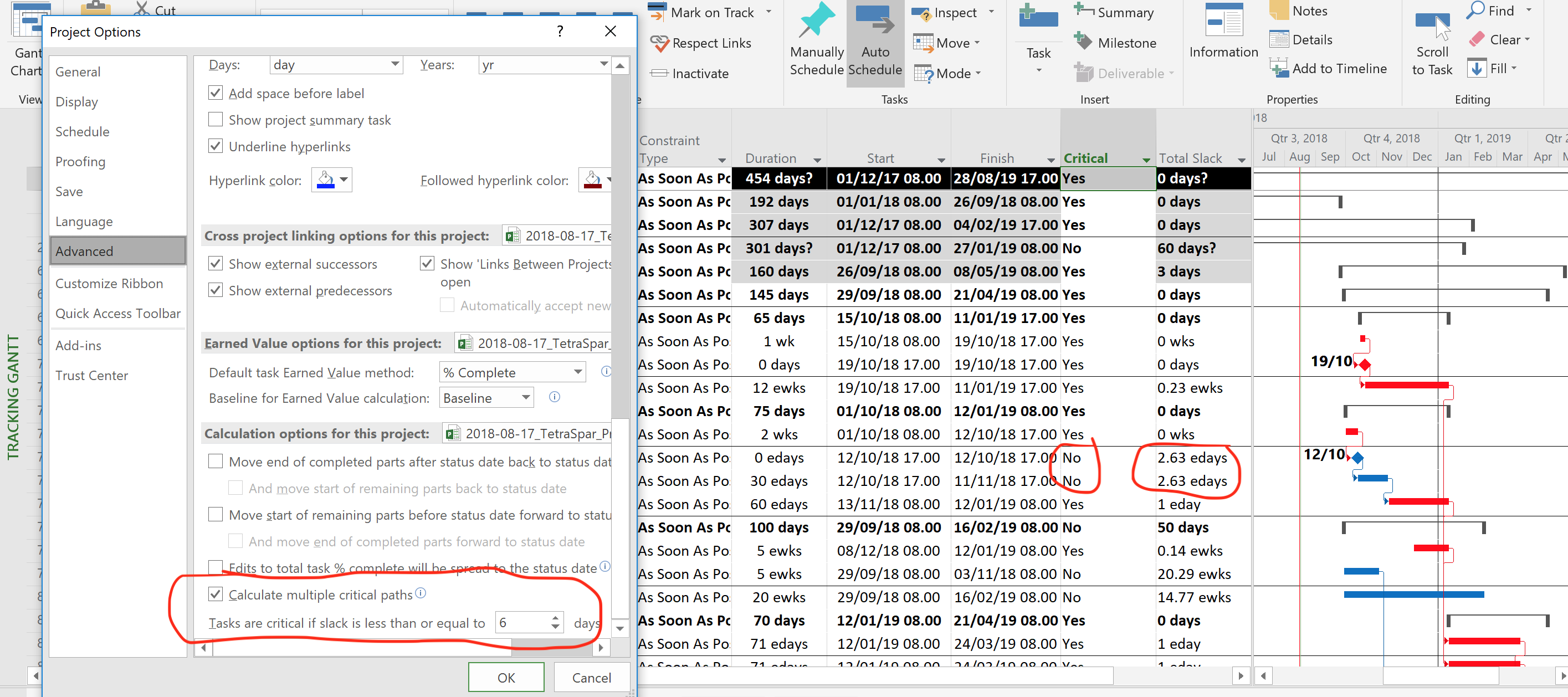

Microsoft Project Member for 18 years 11 months Member for 18 years 11 months Submitted by Tom Boyle on Mon, 2018-08-20 14:35 Permalink Henrik, glad you got it Henrik, glad you got it sorted. Member for 7 years 2 months Member for 7 years 2 months Submitted by HnrKbh on Sat, 2018-08-18 18:59 Permalink Many thanks Tom! Brilliant Many thanks Tom! Brilliant :-) I should have thought of that. Member for 18 years 11 months Member for 18 years 11 months Submitted by Tom Boyle on Fri, 2018-08-17 17:28 Permalink No bugs.Assuming you've left No bugs. Assuming you've left the project's "hours per day" at the default value of 8, then your critical slack threshold of 6 days is 6x8=48 hours. On the two tasks selected, the Total Slack is 2.63 elapsed days x 24 hours per elapsed day = 63.12 hours. Since 63.12 > 48, the two tasks are not Critical. For these tasks to show as Critical, you would need to increase the critical threshold from 6 days to 8 days (i.e. 64 hours). In this case, your true Critical Path might be difficult to discern without tracing the driving logic. Good luck, tom Log in or register to post comments

7 years 2 monthsMany thanks Tom! Brilliant
